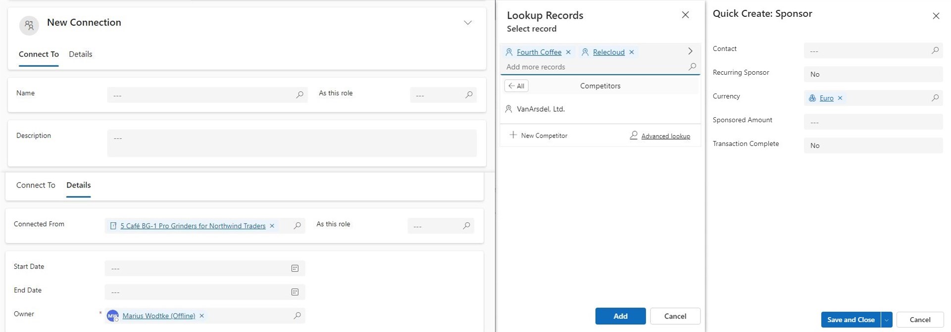

The Competitors grid is found at Opportunity. Add Existing Records opens Select Records where multiple competitors may be selected.

The Sales Team grid is found at Opportunity. + New Connection opens Select Records instead of a Create Form.
When you make a custom subgrid for connections on a form, the + New Connection will open a Create Form. Unfortunately for some reason Quick Create is disabled for this table… And this is problematic for the user experience when users need to associate multiple records to the current one. This is also why other authors shy away from using this feature more.
My Connection is a regular subgrid I put to the form. + New Connection opens a Create Form, leaving the current record.

I strongly advise you to enable and create a Quick Create Form as this will speed up the association process a lot for the user. To showcase this I created a Sponsor entity that connects an Event to a Contact but also needs to additional information specific to the process (while Amount could be general, Recurring Sponsor is not) and processing information that might be updated or triggers logic (Transaction Complete).
Sponsors is a regular subgrid I put to the form. + New opens a Quick Create Form, the user still sees the current record.
