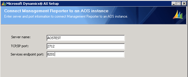

Type in the details for the AOS you want to the Management Reporter Service to connect to. This is neat if you want to diversify what AOS you want to handle any load.

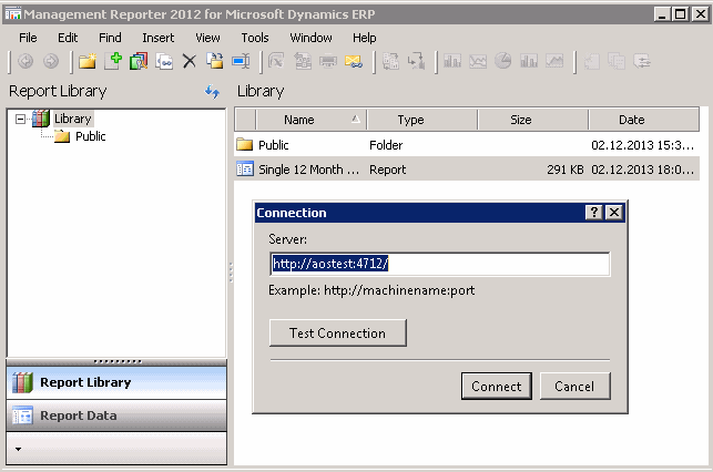

First, let's test the Designer. Locate the shortcut "Report Designer" under the Start menu.
Enter the url to the server and port where the Management Reporter is running and connect. This is a one time per user per machine thing (as far as I know).

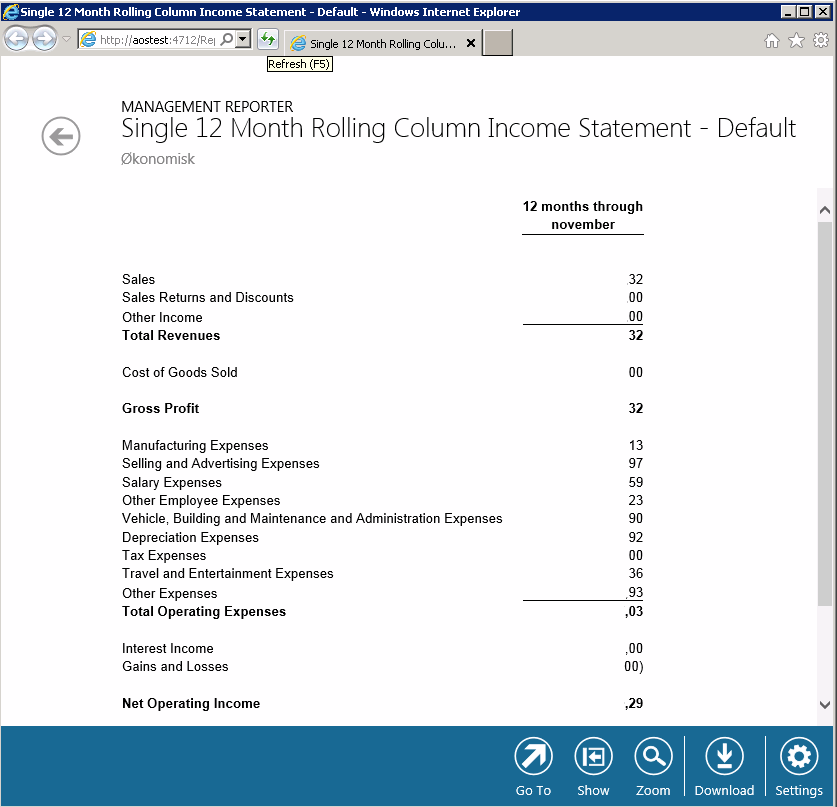

Select the first report and hit "Generate" on the toolbar.
Observe while the report is generated. Let it complete and wait for the report to be launched in a new window.
And the report should open. Yea, I hid some of the numbers from my demo.

Now for the Viewer. Locate the shortcut "Report Viewer" under the Start menu.
This tool might also need to have its connection properly set. The setting is under Tools, Connection.
Double click the generated report located in the Report Library and observe it loads an integrated view of the report.
